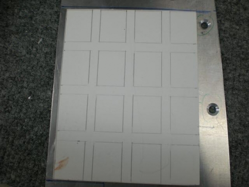

Brief Description:  Redesign Left Hand Breaker panel
I decided the left angle panel on my left console would be great real estate for a breaker panel. I am going to use a number of breakers for my electrical system as well as a fuse block.
I felt that this panel wouldn't be as good for switches as the engine controls are in that area and may make it difficult to access switches at times but would be a very visible place for the breakers.
I originally drew up a layout for 12 CB's....but after further designing and thinking I decided to add four more breakers. I plan to have a majority of my avionics and "critical to disable" circuits like the flaps and trim should the event that a switch should fail it would be an alternate way to kill the circuit.
Anyway I drew up the new pattern for the increased breakers and it seems there will be adequate room for them.
Redrew Breaker panel from 12-16
