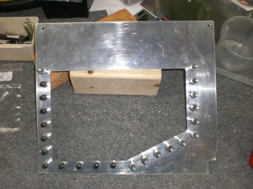

Brief Description:  Forward Baggage Cover Panel #8
I grabbed the three layers of the electrical bay cover panel that will keep things from falling into the area of the front baggage area that I have decided to make my electrical bay..
I cyphered, measured, and marked all the rivet locations on the top panel and then stacked the top and spacer panels together and match drilled them.
I deburred all the holes and then cut a piece of hinge for the door.
Rivets marked and drilled
