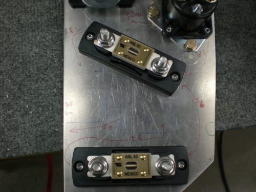

Brief Description:  Electrical compartment mounting panel #4
This session I continued with mounting the electrical items on the panel. I located and mounted the current limiter holders. I have two holders as I am installing both a primary and a backup alternator. The primary will be a 60 amp and the standby will be a 40 amp. Rather than running circuit breakers to the cockpit the current limiters will do a fine job and really cut down on potential electrical noise in the system.
Also, in my aviation flying I have had alternator CB's pop a couple times.....they are high amperage and you don't really want to play with resetting them more than once. On ALL occasions the CB wouldn't reset or it reset only for a few moments before tripping again. To seek to get it reset will be taking a big chance of starting an electrical fire! Point is...the current limiters will work fine.
I only have one shunt block for my panel as the other shunt will come when I buy my avionics. But I used the block I have to install the position for both shunts. The shunts provide information on the alternator outputs during operation to the ammeters for the primary and standby alternators.
Current Limiter holders mounted
Locations for Shunts completed
