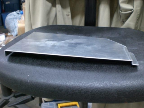

A friend Rob has a box break in his hangar that I have access to. I went down early around 0630 one morning and used it to make the bends in the the electrical mounting panel. I never used a box break but it wasn't that hard to figure out. I made the bends and finished up in a little over an hour.

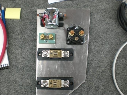

When I brought the panel back I checked it for fit and made just some minor adjustments to it. Then I took some time to start figuring out where I am going to mount everything. I played with a couple configurations but haven't locked down where I am going to place everything yet. I will continue next session and starting mounting the components.
Mpunting panel bends made
Configuration 1
Configuration 1
Configuration 2
Configuration 2
