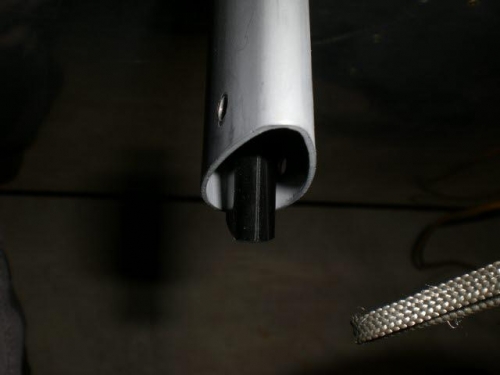

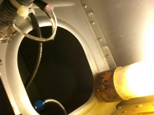

I wired the connector for the pitot tube heat. I am using printed paper labels and clear shrink wrap to hold the labels. These are pretty much the first wires I have connected on the project.
I am trying to leave service loops in case wires have to be repaired in the future so that is one concern I wanted to address. The next is keeping wires secure and protected so they don't rub or fray and get shorted, so I used some spiral wrap, shrink wrap, and zip tie anchors to secure the bundle.
