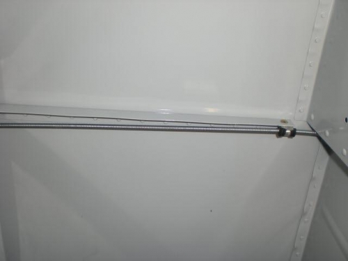

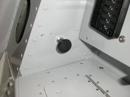

I continued with the routing of the control cable to the butterfly valve. One would think some of these items would take only a few minutes to perform.....but by the time you decide on the course of action then mark and drill holes, install pass throughs....before you know it almost three hours have passed!!!

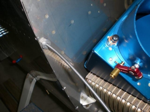

I added the adel clamp on the rear side of where the cable exited the gear tower on the angle attached to the fuselage side skin. I then located the firewall passthrough. I found a Bowden 3/16 inch cable clamp. The size was just right and I carefully located it in a small area between the side fuselage skin and the firewall angle and drilled the hole for installing it.
Last step will be attaching the cable to the butterfly valve arm.
Oil cooler control secured
Routing thru right gear tower
Thru lower baggage and F/W
