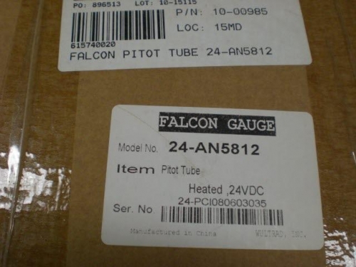

I went through boxes and pulled out manuals to see what I need for fuses/CB's and the electrical draw on the system. When I bought the airplane kit from the previous owner, the pitot tube was already installed and I never thought much about it. Well....I should have looked at it.....because the pitot tube box and the information stamped on the pitot tube itself shows that someone purchased and installed a 24 VOLT pitot tube. I mean seriously VERY FEW small aircraft utilize 24 volt systems!!! Anyway, a call to Falcon that makes the pitot and I am trying to beg for mercy and see if there is anything they can do to give me a break on a 12 volt pitot head....sheesh!

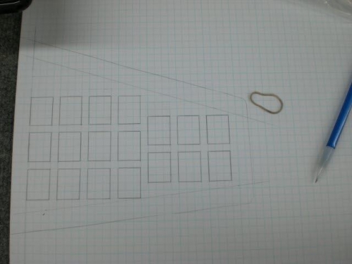

Using the Klixon profile I began to layout the breakers that I have room to install on the cockpit side panel I made. It looks like I can get 18 CB's on the panel in addition to the 24 slot fuse block. Funny thing is I am not sure that will be enough....hmmmm....still calculating that number.

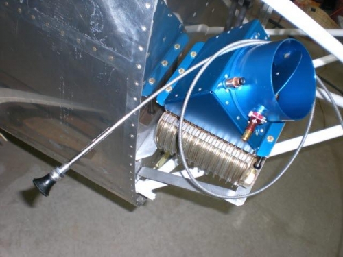

I have an order of electrical stuff coming in that I ordered after doing inventory. My backordered control cables for the oil cooler and heat box came in this week.

Dang....wrong pitot tube
Potential CB's for side panel
Backordered cables arrived
