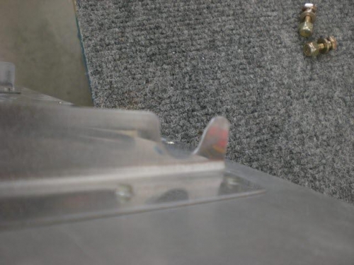

I put my floor on the forward baggage area and found it wouldn't go down all the way. Upon looking for the problem I found a floor stiffiner that was sitting on the parking brake cable I installed. So the best fix was to remove a small area of the stiffiner to go around the cable....problem solved.

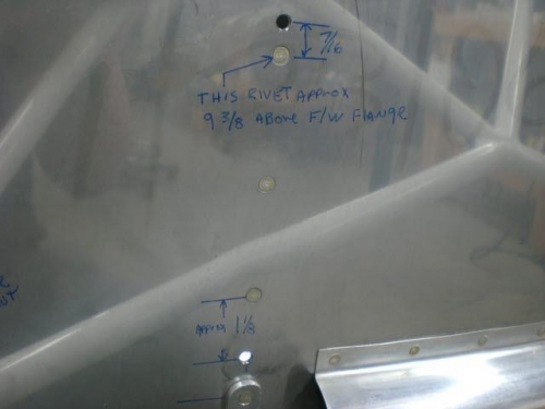

With the oil cooler mount removed I decided to mark and make notes on the firewall for installation. If you are viewing this log and interested in getting anchor points for the mount to anchor into structural parts behind the firewall this will help you. Check out the distances and locations and it should get you really close.
DISCLAIMER: These are just for reference.....your fuselage may vary a little so double check that these dimensions will work for your fuselage!
Modify Stiffner for Park Brake Cable
Oil Cooler Mount anchor points (left side)
Oil Cooler Mount anchor points (right side)
