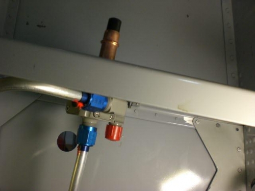

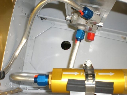

I had the fuel bracket clecoed in place and attached the fuel lines I had made months ago. I torqued them and put torque seal on to verify they had been done.
I decided to permanently mount the fuel valve bracket. I originally put in holes to rivet it on but after trying to get a decent method to buck or squeeze the rivets and haveing to drill out a couple I decided to countersink the holes more and drill out a little and put #8 screws with nyloc nuts. It was easier and quicker and now the bracket can be easily removed if need be and I can move on!
Fuel Lines connected
Lines and bracket
Lines and bracket
