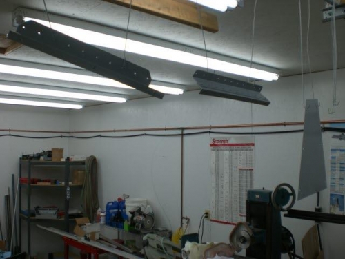

I drilled the clearance holes in the cover and angles then riveted all the nutplates on the angles.
I used the scotchbrite to prep and then painte the parts to let them dry. I am waiting on my Bussman Fuse Block I ordered after Ralph highly recommended it. It is on back order and I find that rattle can spray paint really takes some time to gas off and dry sufficiently. I figured it would be best to paint it and let it dry as the parts won't ship for almost a week. I also have heater vents that are scattered in the basement so I hang my parts where they will get the warm air passing over them when the furnace comes on....it is still cool weather back here so that will work good.

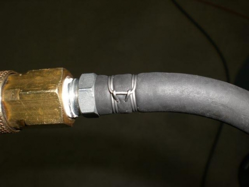

My airhose got compromised by a small hole near the fitting so I took a few minutes to cut it back a couple inches and re install the fitting. I really LOVE using the Clamptite tool whenever the need provides the opportunity. The Clamptite tool that I bought at a Sun n Fun vendor works a thousand times better than any hose type clamp and makes a really neat clamp. I have NEVER had one leak or fail....this is a great tool!
Fuse/CB comp parts painted
Repair air hose with Clamptite
