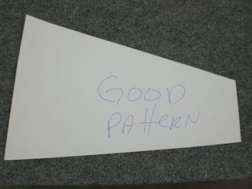

I completed the dimples being wary not to have another lost die. After all the mechancical work was completed I worked on a pattern. It was a challenge in itself as none of the sides of the panel are perpendicular. It took several iterations of patterns until I came up with the perfect fit using poster board. Now to mark and cut the real thing. I will leave a little extra for adjustment when cutting the panel. I have some .040 aluminum that I plan to use.

Cover pattern successful
