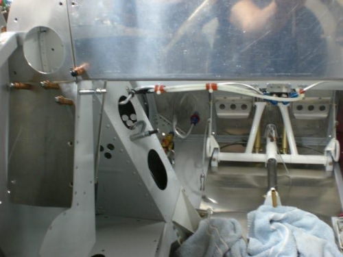

I reinstalled the instrument panel frame that I had removed when we were putting the landing gear on. I wanted to see if the view of the parking brake would be obstructed in the location I had selected to put it. Location and visibility seem good.

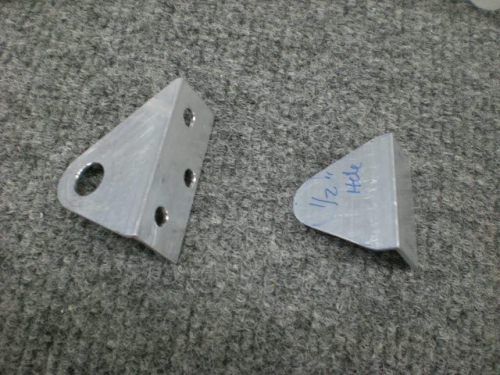

I had made the bracket for the brake cable and it fit great. As I was testing the fit and surveying the routing of the cable it became immediately evident that the setup would require a support bracket in the front end of the cable. I found this out while routing the cable and saw that the front of the cable handle assembly needed to be supported to remove stress on the handle assembly. So I quickly sketched up and cut a rough blank for the front support bracket.

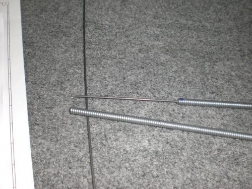

The cable was far too long for the purpose so I made a rough cut to get rid of some of the cable that was making it more difficult to handle in the confined space.
Instrument panel reinstalled
Parking brake cable brackets
Parking brake cable cut to length
