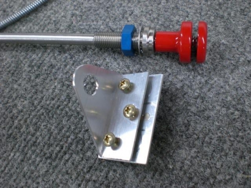

Brief Description:  Parking brake handle bracket
I decided to tackle the bracket to install the parking brake cable. I decided to mount a small bracket on the outside of the left gear tower in a place out of the way but visable. I designed a bracket that would be minimul in size and removable in case it had to be for MX work rather than riveted on.
Once again after pondering the design and modifying it a couple times I settled on what you see below. I made the angle on the top 18 degrees so it would align parallel to the floor of the airplane.
Design and manufacture complete now I will tweak exactly where it will be mounted on the gear tower.
Parking brake cable & bracket
Backside of bracket
