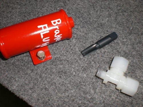

I then installed the fittings for the brake lines and installed the rudder pedals into the airplane. As I was installing the static brake fluid plastic lines I could not get the "T" fitting to thread right into the reservoir. I removed the reservoire and got the1/8 pipe tap to dress the threads. Some metal was removed and when I tried the fitting it fit well. I made sure to block the hole at the bottom to prevent any chips from entering the reservoir.

Retap Brake Res
Retap Brake Res
