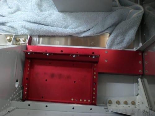

Brief Description:  Battery Mount
Worked on the battery mount tonight. I did not put on nutplates or rivet the battery tray or other parts prior to anodizing as having metal parts on the aluminum parts is not allowed during the anodize process.
The battery tray needed several nutplates and other pieces riveted on to it and took the longest to prep. The anchor bar at the botom and the angle on the left also needed nutplates. You can see the full design and process in the earlier logs in my site.
I am waiting not on installing the rudder pedals prior to putting the mount in permanantly.

How the mount will look
Dummy battery case in place
