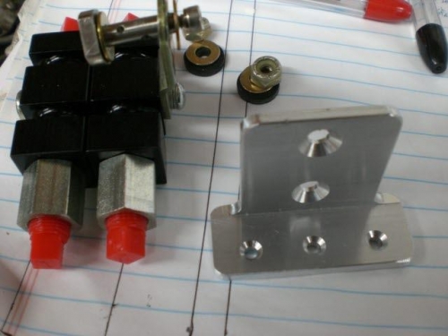

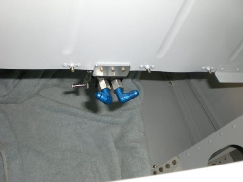

I installed the baggage shelf and found out that my bracket for the parking brake module would not fit because the shelf interferred. After trying to see if I could make it fit I decided to make another one so It was out to the shop and I fabricated another bracket with an additional 1/8 inch of clearance to make sure there would be no interferrence. I installed the fittings in the parking brake module and rivited the bracket in the ariplane.

Parking brake...new bracket
Bradket Installed
Bradket Installed
