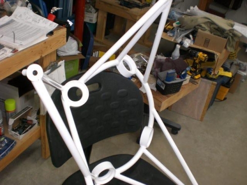

Rob suggested I get the engine mount drilled. That was a great idea. I am trying to get all the "dirty" work done in order to not have to be vacuuming up a bunch of chips from drilling here and there. There will always be more holes to drill (wiring starting soon) but hopefully it can be mitigated.
I started by checking the holes in the mount. I found that some welding burn thru left some lumps in the hole that stopped the bolts from going through. I drilled the holes but had to file with a rat tail file in order to work the lumps out and finally I had a nice fit for the bolts through the holes. Took a bit of time to get them all right with drilling and lots of filing. I don't know if everyone has issues with that on their mounts but it was quite a bit of work and it is finally rectified.

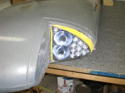

Next I decided to get back on finishing to fit the left landing light so both lights would be up to that point anyway and then I may divert for a bit. After working it for a while I finally called it complete. More work to be done on the lights but at least they are at the same point.
Mount holes worked
Mount holes worked
Left landing light fitted
