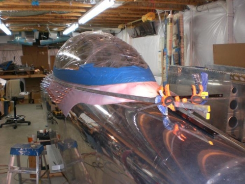

I made some adjustments to the original band clamp that I made to hold the skirts in place while the Sika cures. I had aluminum bar stock that was 1/2 inch thick that was too rigid. I bought the same size stock again only it was only 3/8 inch thick. That had just enough flexibility for clamping and forming around the skirt curve. I used a few shims on the clamp to get the pressure points on a couple spots that needed to be squeezed specifically.

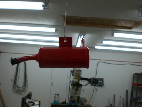

I decided to paint my brake fluid reservoir before calling it a night. I was going to paint it white but the white rattle can was not working......so I painted it red instead since I had that color!
Thinner band clamp
Thinner band clamp
Brake Reservoir Painted
