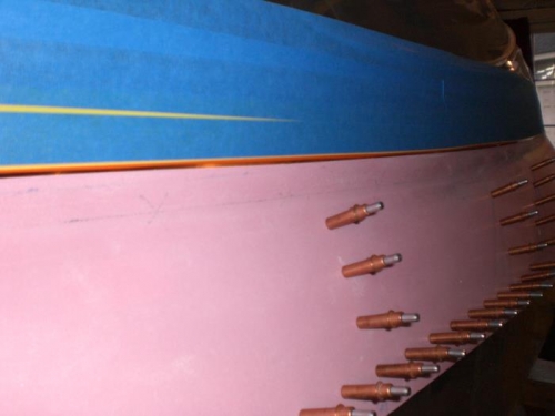

Brief Description:  Canopy Mask for skirt bonding
I took time to prep the canopy for getting the skirt bonded by putting down electrical tape and another plastic tape for rough and finish bond lines. The canopy is ready for the bonding other than protecting it while priming with the Sika primer which I will do the day of the bonding in a couple weeks.
