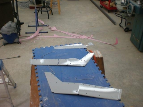

With all the paint mixed and in the gun I went about shooting the parts. I had to saturate the color on the fairing which meant minimum of three coats....a tack coat, a perpendicular tack coat, and finally the finish coat. I used about 4 coats. The panels only required a tack coat and finish coat due to having color saturation. The whole process didn't take long and I had just a little paint left in the cup when all was complete. Now they can cure while I am gone for work.

Panels repainted
Panels repainted
