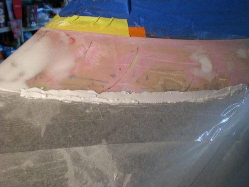

I laid micro on the flox after sanding the roughness off the flox early in the morning prior to us leaving for church. The micro cured over the day while we ran errands and I was able to sand it. I had to put a little more micro on the bottom 2 inches to the left and right of the slide rail for a small gap that was on each side. When the micro cured I sanded it in just a short time.
I pulled all the wax paper and packing tape off the fuse that I had protecting it.

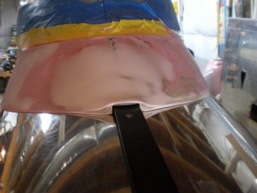

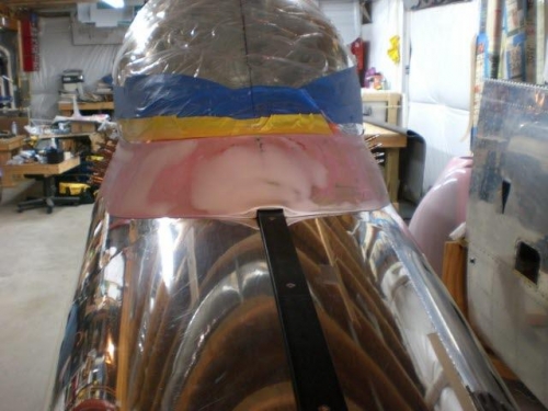

I AM OFFICIALLY CALLING THE SKIRTS GOOD!!! The next step will be to prime and paint then bond the skirt to the canopy and rivet it to the frame!!!
Flox covered with micro
Looks good
Looks good
Calling it done.....ready to bond
