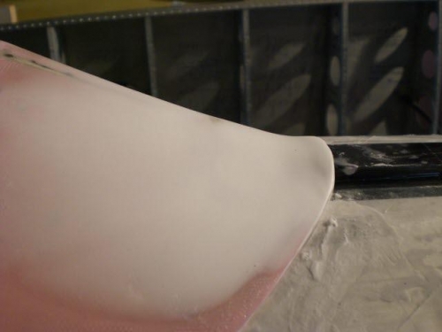

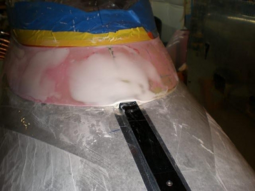

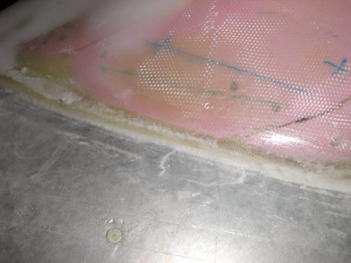

I then sanded the canopy bow that was slathered with micro last session and shaped the bow to give it the look it needed. Lots of sanding. I looked through the front of the canopy to see what it looked like as far as the seal between the rear bow and the fuselage. The right canopy skirt had some light coming through where I was a little careless when working all the glass work I have done on the right side. So I mixed some cotton flox and laid some along the back edge of the skirt and shut the canopy to let it form around the package taped fuselage.

Bow sanded
Bow sanded
Profile of Bow
Profile of Bow
Floxed
Floxed
