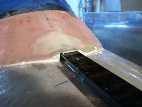

This session was simply a whole lot of sanding. I sanded the outside of the rear skirt and then sanded the inside of the skirt where I put the micro last session.....like I said...lots of sanding.

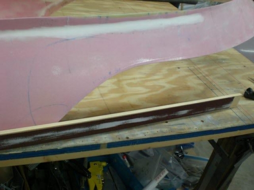

As I was working on the skirt sanding I wanted to make a flexible straight edge to sand the top edges of the sides of the canopy skirts because they still had some waviness for high and low spots.....so I took emery cloth and uses double sided sticky tape to attach it to a piece of wood.
I used it a little but the 3/8 thick wood is a little too stout too use it to follow the skirt countour. I am going to pick up some 1/16 th aluminum at the hardware store....that should work nice.
Sanded outside
Sanded outside

sanding stick
sanding stick
