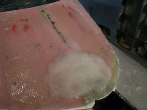

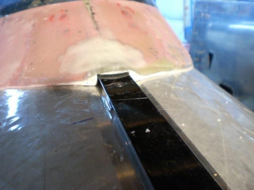

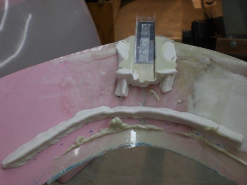

I removed the skirt and began removing clay. After getting the clay removed I used the dremmel to clean up the notch and areas where I laid the glass.
I sanded for quite a while to get things looking good. I mixed some cotton flox and laid some on the back of the skirt area to make transitions around the notch area and I also laid some micro on the inside of the skirt.
Generally I look for anywhere that needs micro or glass laid and I will mix the resin and do that work and then use the excess to make flox for other work I am doing....that way I seem to waste less resin that sits hardening in a cup.
