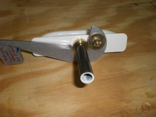

While the micro was doing it's slow process of curing I decided to break off fiberglass and get back to some mechanical stuff such a putting the latch together. The only problem is that the drawings on the Van's bluepring really has a lot to be desired for an old toolmaker. I wasn't sure of the positioning and bolt location...some reason I had a brain block....called my buddy Jim and he claified it....thanks Jim! I had to do some filing and fitting to get the detent for the brass spacer to fit correctly. It felt good to do something without fiberglass!!!!

Latch put together
Latch put together
