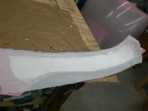

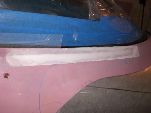

I had a lot of work to do after removing the right skirt. I use an arsenal of sanding devices and dremmel tool to get it close and work the fglass pieces into shape. This session was no different. It took a bit of time but I eventually got it done. It was actually time to start the process of adding micro to start bringing the fairings up to finish.
Up to now I have been using flox which is a mixture of epoxy resin and cotten fibers. Flox is a structural mix that is very strong AND VERY HARD TO SAND!!! Micro is a mixture of epoxy resin and small glass bubbles (they are like a powder.....very important to use a mask when mixing these as they are not good to breathe!). The mixture makes a non-structural blend that is used for bringing the imperfections in the fiberglass part to it's smooth finished shape.
At the end of this session I added the Micro to begin to move these fairings toward finish.
Glassed and floxed....time to work it!
First coat of micro
First coat of micro
Fill in grinding areas with micro
