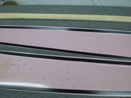

I had marked cut lines on the top and bottom of skirts to make more cuts in the last session. I made a little adjustment to the lines that I thought would look and flow better.
I reallly like using electrical tape to mark lines with a fine point sharpie. The electrical tape is really flexible and you can get the lines right where you want them and when they are where you want them just run the fine sharpie along the tape line, remove tape and you have a great cut line.
