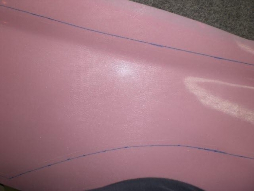

Brief Description:  Mark Skirts for cutting
After making the dotted lines with the keystock I used electrical tape to connect the dashes and draw the cut lines on the skirts. Then I ran the fine point Sharpie along the tape and make the lines. This method works great. The electrical tape is great for profiling lines and the Sharpie follows along and makes a great line.....remove the tape and you have it!
That's all for the short session.
Electrical tape for lines
Lines drawn with electrical tape
