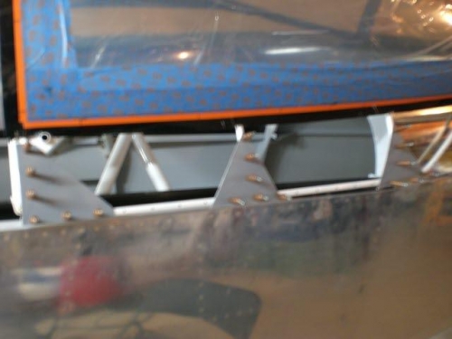

Just drilled templates for skirts. The triangle templates will be located using the holes drilled along the bottom tube on the canopy skirt and clecoed then the holes along the ribs can be drilled using the templates. The bottom holes on the canopy skirts can be drilled using a hole duplicator tool whereas the rib holes are best drilled using the templates.
Then I made spacer block for keeping the canopy open 1/8 inch for the canopy skirt "preload" for lack of a better term.
Templates Drilled
Templates Drilled
