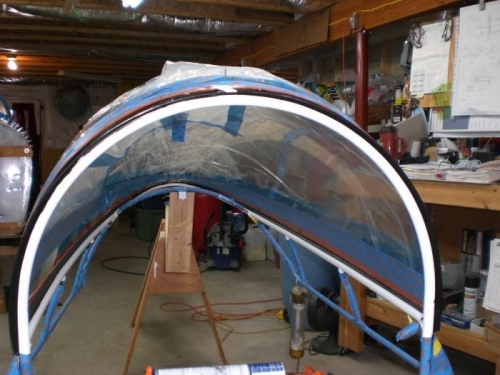

Brief Description:  Prepping and Sika Bonding #5
I allowed the Sika to cure for about 58 hours before taking off the clamps. I then used the process to do the canopy bow with aktivator, primer, and sika. The process went quite a bit faster since it was easily accessible and a lot shorter run.
After doing that I ran a little cosmetic sika in some areas and called it good. It is by no means perfect but I am happy with it. I removed the tape and put the canopy aside to cure.

Frame Sika process complete
Tape removed
Tape removed
