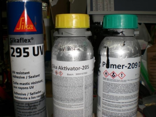

Brief Description:  Prepping and Sika Bonding #4
Well today is the day I will spend some quality time bonding with my canopy! haha Other commitments postponed the bonding process yesterday but now I am ready to attack the "one shot" to get it right process of bonding.
I consulted one more time with Jim to ascertain that I had all ready and the process down. The process in a nutshell is this:
1- Clean all surfaces with alcohol and blow off with clean air and let dry
2- Brush on Aktivator 205 to the canopy and canopy frame - let dry (about 10 mins or so)
3- Brush on Sika Primer 209D to the canopy and canopy frame bonding area and let dry(30mins?)
4- Set canopy on frame in proper position
5- Bond with Sika 295UV to bottom and top of canopy bonding area.
That’s the process in a nutshell. Now for other details:
a) Get a bunch of acid brushes - I would have about 20 on hand. I was able to use one to brush all the Aktivator 205 on all the parts. I used at least 6 brushes for putting the Sika Primer 209D on the frame and canopy. The primer begins to get gooped up on the brush so when that starts to happen just throw it away and grab another one....it's not worth the fight with a hardening brush.

The bonding substances

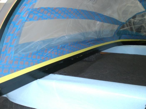

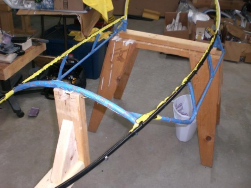

Canopy frame primed
Canopy frame primed
Canopy primed
Canopy primed
