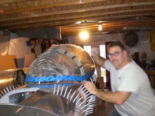

When Rob showed up we headed down and continued determining where to remove material for the fit of the canopy to the fuselage. After a few sessions of carrying the canopy back and forth to the shop and cutting, sanding and smoothing we had the canopy sitting on the canopy frame bow. There was still a little space between the windscreen bow and the canopy. Plans call to remove some material from the bottom of the canopy bow where the wheels go in order to lower the canopy frame and have the windscreen bow match in height. Rob and I determined a strong 1/16" would be about right. So we removed the canopy and the frame and made the adjustment. The alteration made it match perfectly. After a little more tweaking we were at the point where it was time to make the BIG CUT!

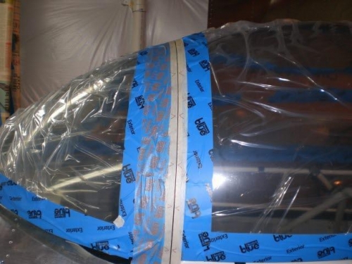

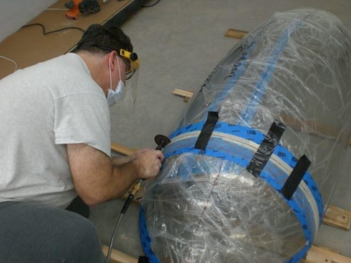

Vans process calls for placing a piece of cardboard between the windscreen and the canopy frame bows and using that as the cut line. Rob uses an alternative process of taping the cut line and using that for guidance. Rob has done two canopies when he build an RV8 and RV7....I was happy to agree to do it Robs way.....experience over instructions on paper is always a better way!!

Working with Rob fitting canopy
Using taped lines for the BIG CUT
THE BIG CUT IN PROGRESS
