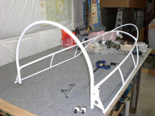

Brief Description:  Canopy Frame Adjustment
I spent some time bending the bow of the canopy frame to tweak it to fit the side rails. A lot of trial and error along with using sheer muscle to bend the frame to get it to fit right. I will have to wait for the new slide block to really get the fit correct....so waiting for the new block to come in.
I also made some metal strips to strap on the canopy ribs in order to check if the frame matches correctly with the fuselage profile for the canopy skirt to be attached.
Tweaking Frame
Tweaking Frame
