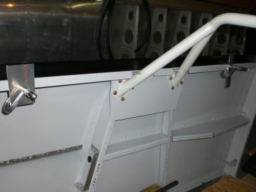

I worked on getting the slide rails set in place. The prints have a callout but basically the slide rails are to follow the inside edge of the F-815 on the left and right sides. Using small scrap pieces of aluminum I clecoed the pieces to the sides and using additional pieces for spacers I got to the print dimension that it called out. That actually seemed to get it pretty close

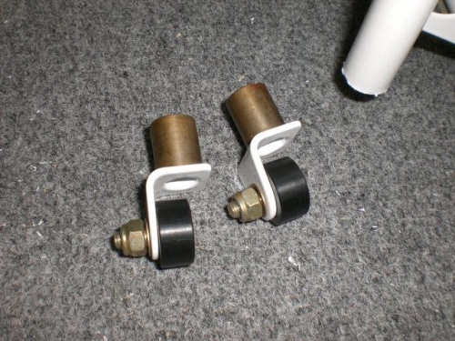

Next I put the canopy roller assemblies together. Something didn't seem right so I called my buddy Jim....well seems my eyes missed a spacer that is called out on the print. Spacer inserted....thanks Jim!
Slide Rails with shims to locate
Canopy Roller Mount Assembly
