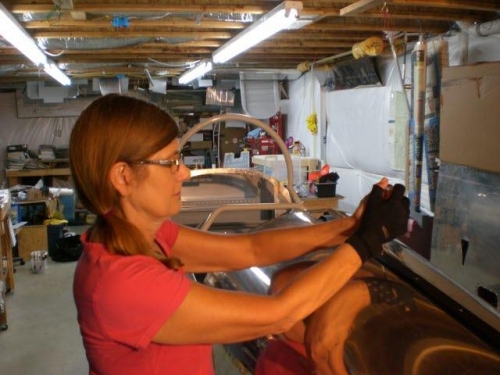

Brief Description:  Canopy Slide Rail install
I was able to get a bit of work done. I started by drilling, countersinking, and pop riveting the #6 nutplate for the removable cap on the slide rail. I had to open up the rivet holes on the nutplate due to the rivets being 1/8 th diameter instead of 3/32 nds.
My Bride was instrumental in getting the nutplate located and riveted. She was also the key to my ability in getting the rail screwed in place. Thanks Sweethart! <3
I used all high torque torx head stainless steel screws to install the slide rail.

My wonderful helper
My wonderful helper
