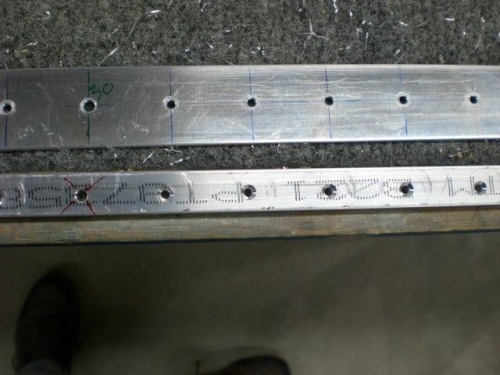

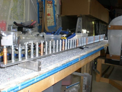

Tonight I continued to drill along the rail till all the holes on the rail were complete. I then drilled the couple holes remaining on the very front of the rail past the bend.
I removed all the clecos and deburred all the holes. The bottom of the spacer gets countersunk in order to make the shop head end of the AN426 rivet flush also when the cap is riveted to the spacer. I countersunk all the holes in the bottom of the spacer.
All holes drilled in the cap and spacer
Bottom of spacer countersunk
