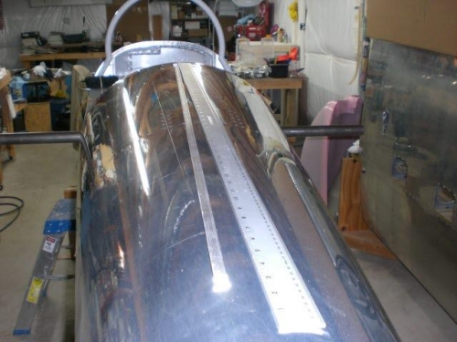

Next instead of drilling the cap I decided to mark the centerline on the fuselage and on the canopy slide spacer. The fuselage centerline is determined by pulling a string ( fishing line for me) from the front of the bulkhead just behind the back seat at the F-807 Bulkhead to the F-810A Bulkhead in the empenage area. Running the line was fairly easy.....I then made marks carefully along the line and then used a metal straight edge to mark the fuselage centerline.

Marking the fuselage centerline

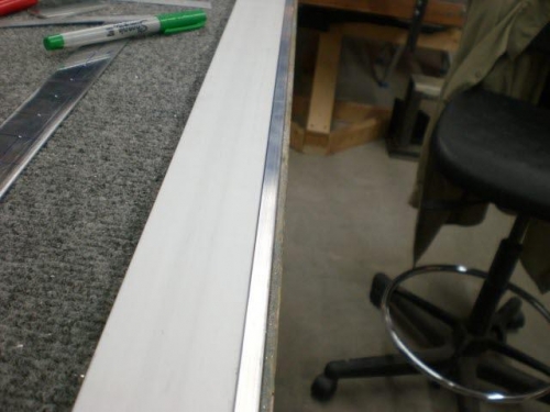

Marking spacer centerline
