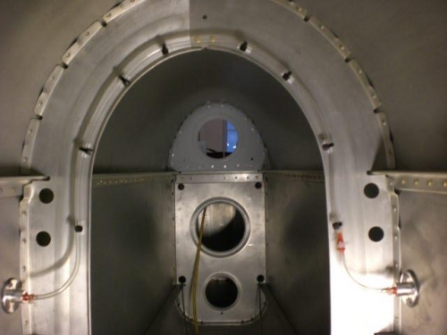

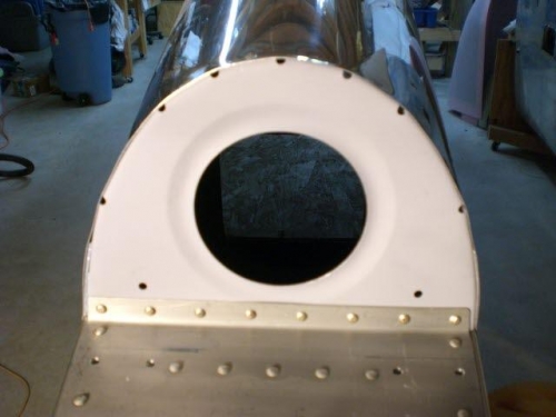

Brief Description:  F-810A Bulkhead - continued
I finished riveting the F-810A Bulkhead. It was a little more of a challange than I thought it was going to be.....and took a little longer than I thought.....but I got it all riveted.
I then completed hooking up the 1/8 inch portions of the static lines up to the "T" where the 1/4 inch lines connect. I am going to wait till I get some more things installed before putting the 1/4 inch line in because I am afraid of drilling into the larger line while installing the other items in that area.

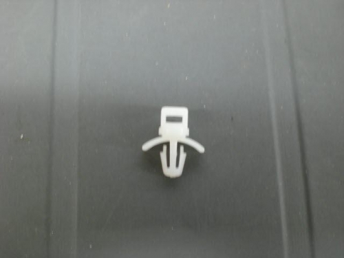

I found these little standoffs for tie wraps that worked absolutely fantastic for running the static line. I just had to open up the bulkhead holes from 1/8 to 3/16 to snap the standoffs in and tie wrap the static line....looks good!
F-810A completely riveted
Installed all 1/8 static port lines
Tie wrap standoffs
Tie wrap standoffs
