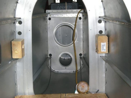

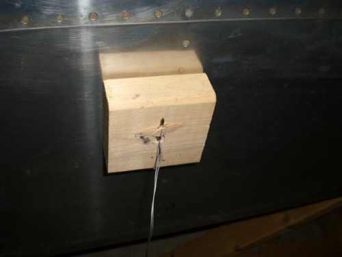

Brief Description:  Static Ports #3
I began by removing the blocks and checking the seat and security of the static ports. The proseal had set up nicely. The holes for the 1/4 inch part that protrudes through the skin had a little proseal that squeezed through around the sides. The hole through the skin was a tight fit but you know how liquid will squeeze through the tinyest of spaces.
I took some "Goof off" which I keep a can in the shop all the time. The stuff removes proseal lickity split....as well as any other adhesives. I cleaned off the proseal from the static port on the out sides of the airplane. Spic and span now.
The vents are done....will let the proseal set up some more before attaching the static lines.

Clamping system
Clamping system
Outside block and safety wire
