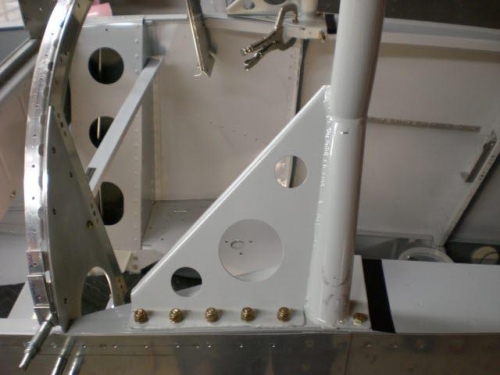

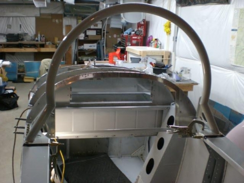

Brief Description:  Windscreen WD-814
With the WD-814 Windscreen in place I clamped it in position while I began drilling the holes from the back and working my way forward. I inserted the bolts as I went in order to keep things tight. I would drill the hole on the left and right outer area then deburr and add the bolts before moving forward.
Lastly I drilled the two interior bolts that hold the weldment to the inner portion of the fuselage.
In addition to being an integral part of the windscreen/canopy structure....it also serves as a
roll bar in the event of an off airfield landing.
Left side drilled
Left side drilled
Overall
Overall
Inside Bolts
