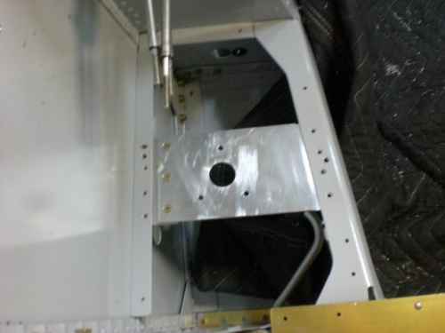

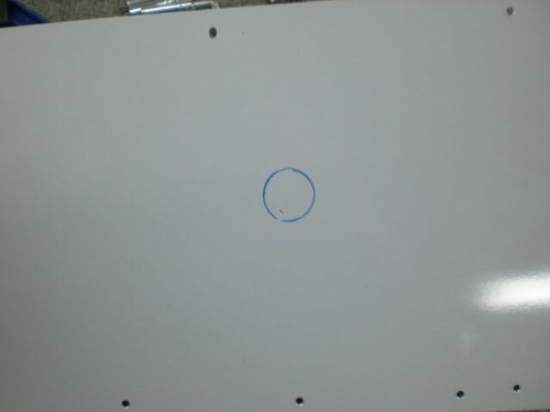

I reinstalled the fuel valve bracket with clecos and marked the location of the fuel valve hole on the bottom side of the mid cabin cover with a sharpie. I then installed the two nutplates that actually had to be installed on the fuel valve bracket itself due to where the mid cabin cover screw positions fell in place.
Fuel Valve Bracket Temp install
Hole for fuel valve marked in cover
