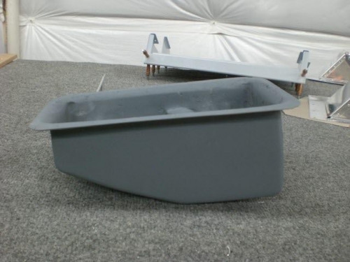

Brief Description:  Mid Cabin Storage Cubby #8
I did a lot more sanding and finishing of the storage cubby. Finally I primed it...sanded it and did more work on it. It is not perfect by any means.....but it will be functional. I began to locate, drill and put nutplates into the cubby. The cubby will attach from underneath so the screws from the mid cabin cover will hold the cubby also. To remove the cubby will only require removing the mid cabin cover screws and the cubby will drop out and slide out of the bottom. Should work well.
Primed
Primed
