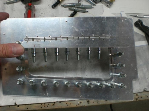

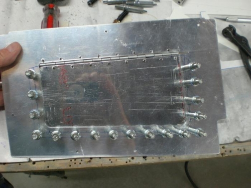

Anyway, I got the entire door ready except countersinking and final deburring.

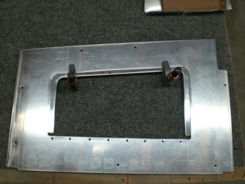

I started by making a doubler that would also act as a door stop. I felt that I wanted a thicker piece of metal for the cover as the Mid Cabin Cover is only .025 thick. I decided that .040 would be good as I also had a sheet in stock that I could use. In order to do so required additional work. To make up for the extra .015 of thickness, it means making a spacer for the outboard hinge half and making a spacer for the door stop doubler so when the door is shut it is flush with the Mid Cabin Cover.
Before selecting the .040 thickness I searched for .015 sheet aluminum which I found in my stack of trim stock. Ok .040 is a go. I had picked up some small MS20257-1 Piano hinge to make hinges for the console compartment and this Mid Cabin Cover. So I measured and cut the hinge.
After making the spacer I located and drilled the outboard hinge.
I then used poster board (which I have found soooo useful to make patterns) and made a pattern by tracing the door opening. I cut the door out of the .040 sheet leaving a smidge extra for fitting. I also made a pattern for the doubler/door stop and cut that out of a scrap piece of .025 sheet and then made a pattern and cut the spacer for the doubler.
Next I began to fit the door to the opening and the hinge. Next I cyphered the spacing for the rivet locations and marked and drilled all the holes.

Cover with Door stop
Fitting door and hinge
