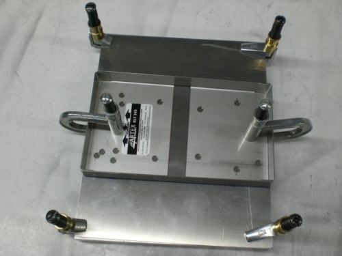

Brief Description:  ELT Bracket #2

Next I continued working on the ELT mounting bracket. I am connecting the bracket to the longerons behind the baggage area. So its time to get that in. I put the two angles and the plate in place with cleco clamps to get tthe fit right. Next session I will mark holes and drill.
Fab the ELT mounting plate
