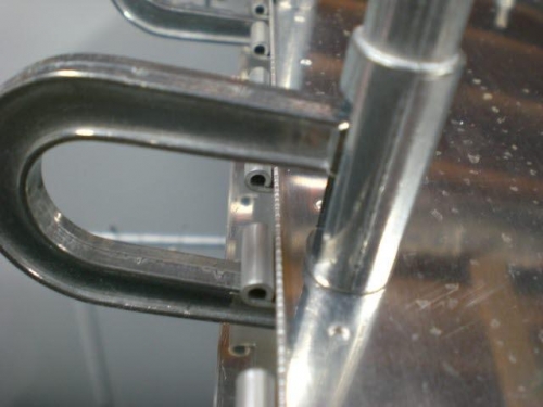

I spent this session getting the setting up and drilling the F-873G Rib, F-873H spacer, and F-873J hinge set in place and ready to drill. Next I drilled the holes using the skin pre-punched holes as a guide.
After drilling I laid the door on the skin. I had to trim about 1/8 inch off the door edge where the other half of the hinge goes in order to have the spacing required on the print.
Setting hinge
Setting hinge
