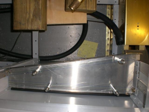

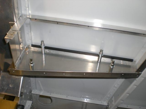

I started with measuring and rough cutting the bottom panel. I can usually cut things pretty close with the bandsaw which was the case with the bottom. Next using the belt sander and files I got the bottom panel to fit nicely.

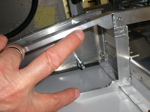

Next I marked where I wanted to cut away parts of the two angles on the top of the compartment in order to give a little more hand clearance as the extra metal is unnecessary for strength of the set up and just is extra weight anyway. So I put them in the mill machine and then deburred and finished off the edges.
I drilled the location for four screws to hold the bottom in place.
Bottom cut and fit
Bottom cut and fit
The bottom is to keep stuff from falling through LOL
Marked and cut more clearance on top angles
