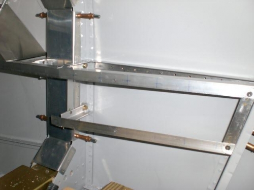

Well I was still doing more fitting and locking down final locations of the angles. I began inserting nutplates in the places I had clecoed. I countersunk the locations that needed flathead screws so the surface would stay level. After installing multiple nutplates and screws the frame was together.
I then set the inclined panel in the front and drilled for the attachment screws to the support angle. Sometimes it seems that all these seemingly little tasks of nutplates and scews sure takes a long time to actually get a finished product. Anyway all done and will work on console side panel next.

Skeleton complete
Skeleton complete
Another photo angle
Another photo angle
