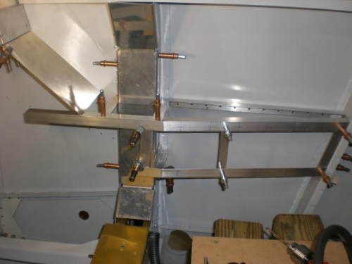

A lot of time was spent cutting and fitting the angles where I wanted them for what will be the storage compartment, so it was a lot of fussin and tweaking to get everything where I wanted it to be.
Now that the main side angle was locked in place I worked on finishing the inclined panel in front of the console. I fabricated an angle that attaches to the bottom of the instrument panel to hold the forward edge of the inclined panel. After cleco clamping the panel to the angle and getting it where I wanted it to be, I drilled the attach angle to the bottom of the panel. Will drill the panel next session.
Building the skeleton
Another pic of skeleton
