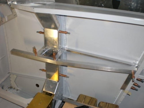

I cut the main profile angle to form the side of the right console. As I was laying on the standoff angles that are attached to the spar channel I realized that the standoff angles were cut a little too short for my liking. They would have functionally worked....but I wasn't happy with them so I took time to remake them. They are made of 1/8 alum angle but I machined half the thickness away from where the side angle will rest in order to have the the top of the console lay flat at the same level. Worked great.

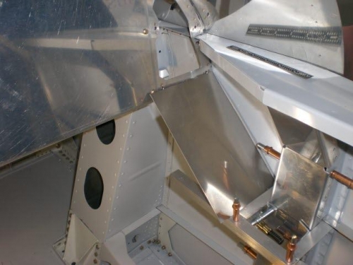

I rough cut the angled front panel. I driled and clecoed the support angles and the side angle to start getting the frame set in place. Will fit the forward angle panel next session.
Main side angle
Main side angle
Rough cut inclined panel
