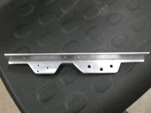

I removed the quadrant and parts. I then marked where I wanted to remove excess material to lighten the bracket since there was no need for having the material since the bracket is plenty stout. This is where having a mill machine is nice....but is not necessary.

Sidewall bracket modified
